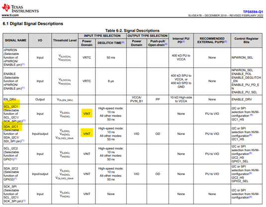

I am using the TPS6594133A with the TDA4VH. The TDA4VH's MCU_IO is supplied with 1.8V. I noticed in the TPS6594 datasheet that its VIH(DIG) and VIL(DIG) are compatible with 1.8V logic levels. Could the I2C interface of the TPS6594 can be directly connected to the MCU's 1.8V IO of the TDA4VH without using a level shifter?

  • Thank you for your reply. Actually, I want to know if using VIO = 3.3V while pulling the TPS6594-Q1's I2C interface with 1.8V pull-ups would still satisfy the VIH and VIL thresholds of the TPS6594-Q1's I2C interface.The datasheet does not specify that the I2C interface levels must meet VIH > 0.7 × VIO and VIL < 0.3 × VIO.
  • Hi Josh,
    That seems to be right. Reason being input direction is always referenced to internal LDO 1.8 V level.
    Br, Jari
