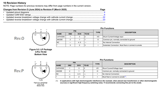

Hi team,
Why is the pinout diagram for the LP package changing?
The pinout has not changed. The numbering scheme has changed. The cathode and anode are still associated with the same pin as before. The numbering scheme was changed to align with JEDEC standards.
