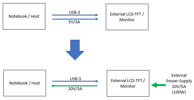

Dear Team,
I'm looking for a PD-Controller for an external notebook-monitor. It will be connected to the USB-C port of the notebook and sinks 5V/3A in the first step. IF an external power-supply (up to 100 W) is connected to the monitor the USB-C port of the monitor swaps the power role and provides power to the notebook for charging. Up to now I used the TPS65987 for the current design. Which IC do you recommend for a new design, as the TPS65987 is no more recommended for new designs? The monitor requires USB only, DP alternare is not required.
As far as I can see the TPS25751 is not suitable, because it can source only 5V3A.
Thank you very much
