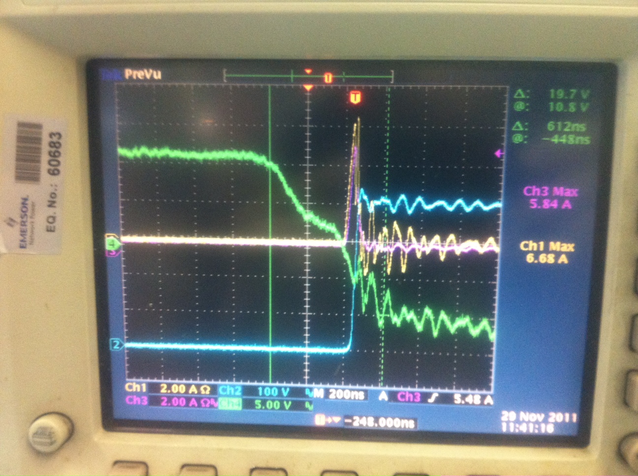

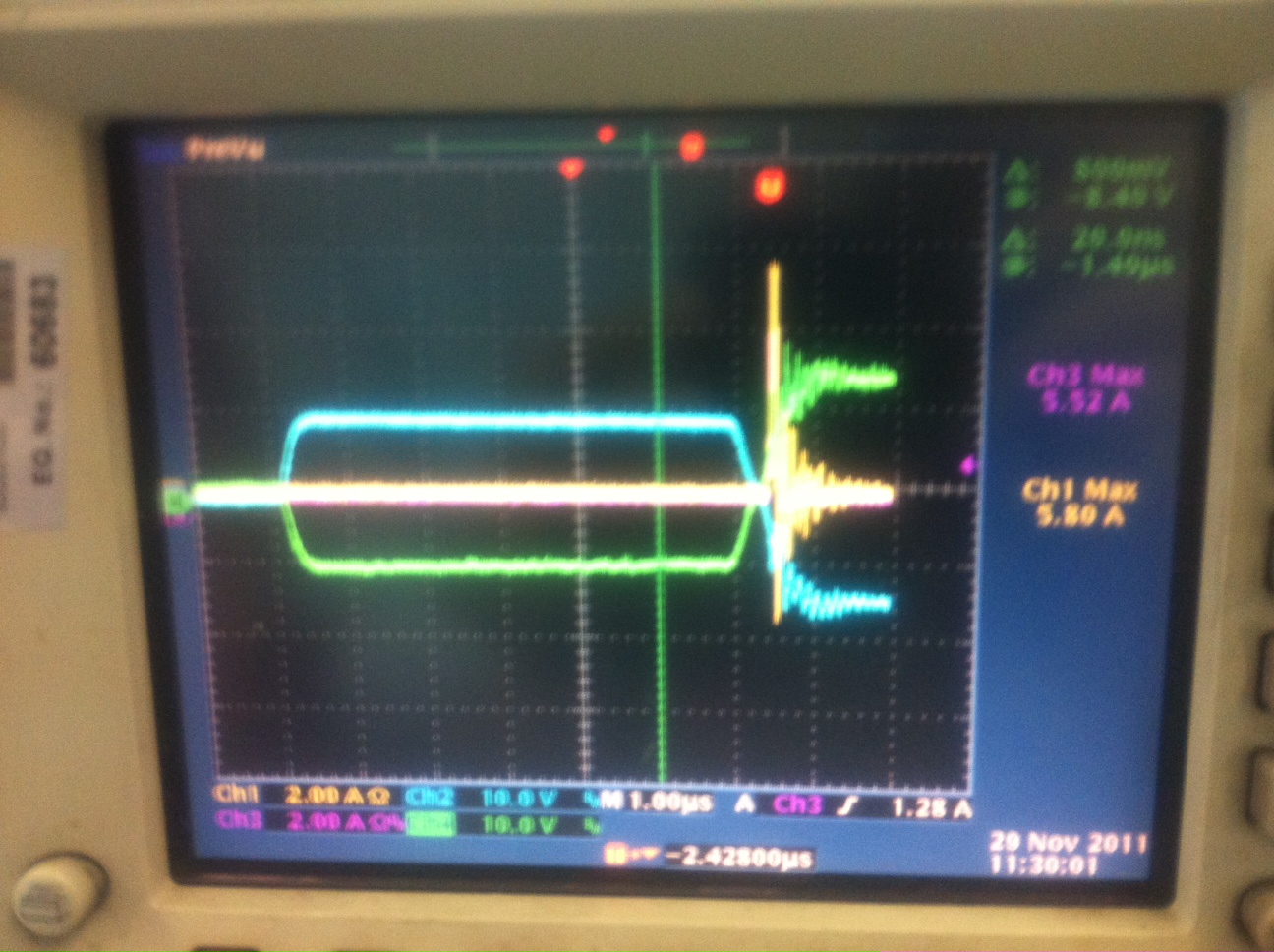

UCC3895 primary MOS burn out in light load or no load
Our customer  find the primary bridge Mosfet would be burn out when the unit operated in no load or light load.however, increase the load, this issue will not happen.
I got some waveform from our customer, much appreciated your comments here.
Pic:ture A
Condition: Normal operation under no load
CH1: Id of Mosfet C
CH2: Vds of Mosfet B
CH3: Id of Mosfet B
CH4: Vgs of Mosfet B
Picture B:
Condition: First start cycle under no load
CH1: Id of Mosfet C
CH2: Vgs of Mosfet B
CH3: Id of Mosfet B
CH4: Vgs of Mosfet C
