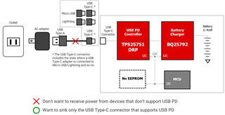

Dear Sirs and Madams,
We are considering using a combination of TPS25751 and BQ25792.
For our application, we do not want to charge the battery when a USB Type-C connector is connected, which does not support USB PD.
So, We found the setting "Do not detect legacy chargers" in the "Enable charging detection" section.
Can We disable charging from an AC adapter connected with a USB TypeA to Type-C cable such as BC1.2 by using this function?
Does "Legacy Chargers" mean 5V/1.5A in general such as BC1.2?
We also don't want to receive power when connecting a USB Type-C adapter to a lightning connector that supports Apple Charge.
The same applies when connecting a USB Type-C connector adapter to a micro/mini USB connector.
Masashi
    Can you provide a block diagram for this scenario? For a USB Type-C to lightening cable, the USB-C side of the cable is always the source and the lightening side is the sink. Is TPS25751 the source or sink in this scenario?
    Is there an EC/MCU in your system that can do I2C write/read to TPS25751 during run-time?

  • Hello Lin,
    The TPS25751 used in our system performs sink(charge battery) and source(discharge battery) as DRP.
    However, when sink from an external device, we do not want to accept 5V/1.5A (USB A to C), which does not support USB PD.
    The system is equipped with an EC/MCU that reads/writes the TPS25751 via I2C.
    Masashi

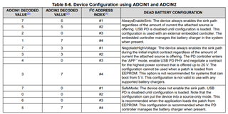

  • that may not be possible when you come up in dead battery mode, unless you configure to not enable sink path unless it is 5V-3A. Please look at ADCIN settings in datasheet, how you can design resistor divider for that.

  • I think, it already does that. The Charging will be disabled by default and upon PD contract the charger is programmed over I2C3.The challenge your saying is not to charge unless it is explicitly a PD contract for 5V/3A
  • Hello Ghouse,
    Please let us confirm for a few points
    I think you will choose AlwaysEnableSink for ADCIN from the options.
    Even in a dead battery state, voltage is supplied from VBUS and settings are written from EMC.
    I thought that there would be no problem if the start of charging could be determined by the GPIO's AttachedAsSink, but is it correct to understand that this is already the case in the current configuration?
    You said "it already does", do you mean that it is designed to only charge USB PD Sink?
    Masashi
  • I was assuming that MCU will program the part first. Even if it is dead battery it will program the Part for sinking. You should be able to log I2C3 messages and check that. GPIO AttachedAsSink will enable the part moment there is a Type-C (cc) connection. Once you have patch loaded, the programming will happen and if you have setup GPIO, it will get enabled.
    Since you have MCU if you prevent the VBUS switch being enabled it may not power the MCU, so you are right you do need AlwaysEnableSink for ADCIN. I had mistakenly assumed that you were booting from EEPROM.
