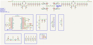

I am using the BQ25756 as a 4S charger. Especially when the input voltage is close to the battery voltage, I hear a buzzing sound. When I observe this with an oscilloscope, I see switching activity on the bootstrap capacitors of both the buck and boost sides. Therefore, I suspect the noise is caused by both buck and boost stages trying to switch at the same time when the input and output voltages are close.
I have observed the same issue on the EVM as well. Although the schematic I attached shows a different inductor, I am actually using the same inductor as on the EVM. The MOSFETs and bootstrap capacitors are also the same as on the EVM. Could you please help me with this issue?

    I've got a few questions to ask about your test conditions:
    • What's the input and output voltage this behavior at?
    • What's the charge current for the battery?
    • Is a real battery or a CV load being used for the BQ25756's output?
    Ethan Galloway
  • Hello Ethan,
    • This issue becomes more noticeable when the charger enters the CV phase. The output voltage is 16.8V, and I can hear a noise when I vary the input voltage between 15V and 18V.
    • The charging current is set to 6A, but the noise begins when the current drops the around 1.5A in CV mode and continues until the battery is fully charged.
    • I am charging a real battery. I have two different batteries in a 4S configuration, and I observed the same noise with both of them.

    Does this behavior change if you set EN_PFM=0? We recommend setting EN_PFM=0 when the termination current is below 2A. You can also use an external clock source on FSW to disable PFM as well.

    I have confirmed that the BQ25756EVM does produce a faint buzzing sound when in PFM mode. I don't think this will be an issue of the part. Can your system work with this buzzing sound?
    If you don't want this noise, you can use a part like the BQ25798. The BQ25798 has out-of-audio feature to prevent audible noise while in PFM mode.

    Thank you for your response. The BQ25798 is not suitable for my application, so I will proceed with the BQ25756. If this noise doesn't cause any issues for the IC, then it's not a problem for me either.
