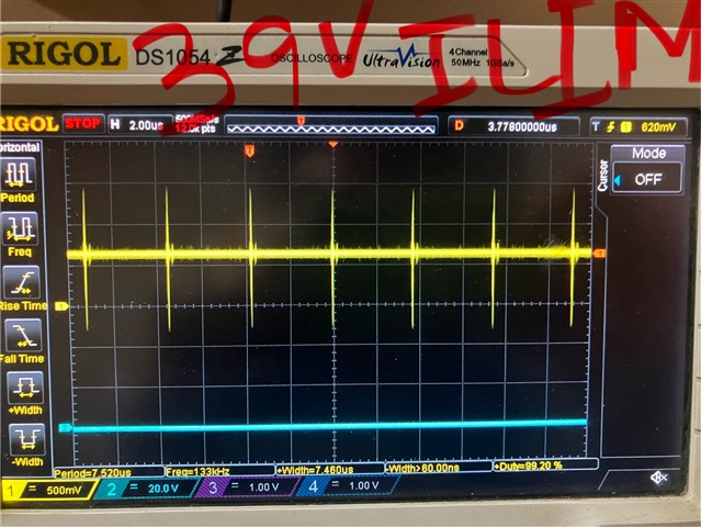

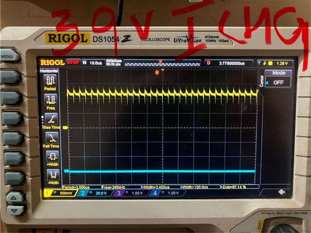

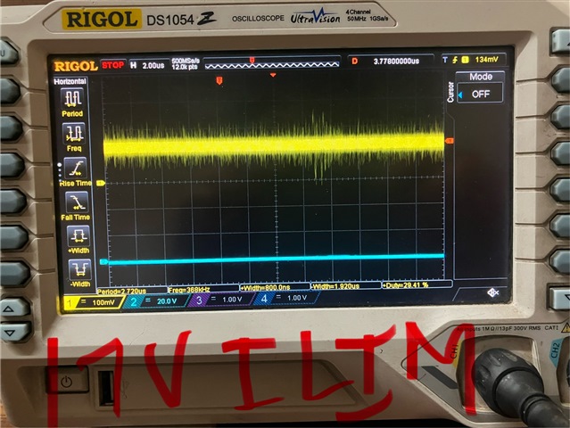

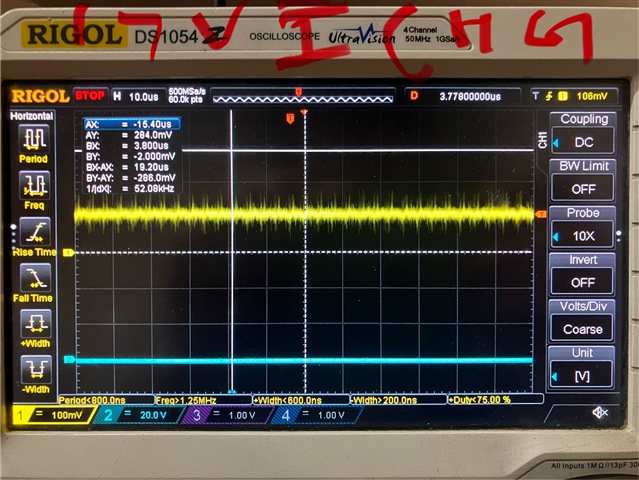

    It was a different issue rather than the DCR algorithm kicking in, the series filter resistor(10ohms) at the input and output current sense resistors were completely open which caused the input to stay at high impedance picking up stray voltages and that triggered the OCP which stopped the charging process. But I could not find out how those resistors blew open? This is the same PCB that I used before , the one with the damaged MOSFETs.
    Yes the MCU did communicate over I2C, there was no issue even when there was not 5V at REGN. But I still could not understand how the series resistors blew open.
    After that I replaced all four series 10ohm resistors and reduced the input current to 4A and output current to 2A and disabled PFM. It started charging the battery.
    But when in boost mode the charging current reduced to about 0.2A (I/P volts: 18-37V) and never rose up even though the IC was in CC mode(charger status register value). And when the input voltage was increased to 39V then current rose up upto 1.5A but again at 40-44V input the current dropped. I also trioed enabling PFM but same result, no change.
    I also added the RC filters at the ILIMz and the ICHG pins as per the EVM but still nothing changed, the only thing that changed was the waveform was much cleaner at those pins than before, but not as clean as it should be.
    Could this be the reason behind the strange behaviour? Or should I make more changes to the hardware or are there something that I'm missing, please suggest.
    I also tried enabling MPPT niether the curent value changed nor the MPPT is working. MPPT parameters were in default setting.

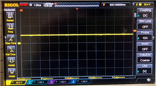

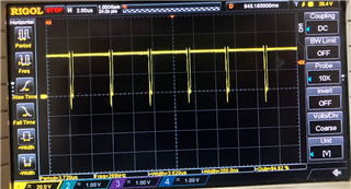

  • here are the scope shots at ichg pin and ilim pins measured at 17V and 39V inputs
  • Hello Tenzing,
    Thanks for the new information. That's a very good find with checking the 10Ω current sense filter resistors. We are swamped at the moment so I'll take a more in-depth look at this later this week.
    In the meantime, I have a few test suggestions:
    • Can you set ICHG_REG to your charge current and then set EN_ICHG_PIN=0? This will make the IC ignore the ICHG pin and only using the ICHG register. Does this change the IC's behavior?
    • Can you do the same test for ILIM_HIZ by setting EN_ILIM_HIZ_PIN=0?
    • After doing the above two tests, can you see if the BQ25750s charge current is related to the VIN/VBAT ratio and not the register settings?
    • Can you try installing a new BQ25750 IC on the board?
    Ethan Galloway
