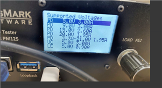

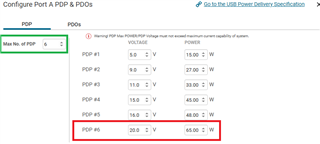

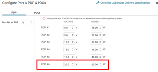

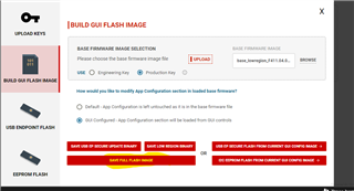

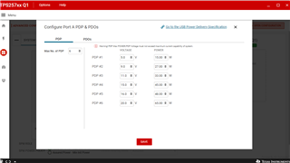

I have generated 65W full flash binary using TPS257XXQ1 gui tool. but when I am flashing it in on board EEPROM it is giving MAX output 60W.
please let me know is there any other parameter needs to set for 65W power.
F411_04_01_0005_ReleaseFiles and base binary image , I have taken from TI resources
