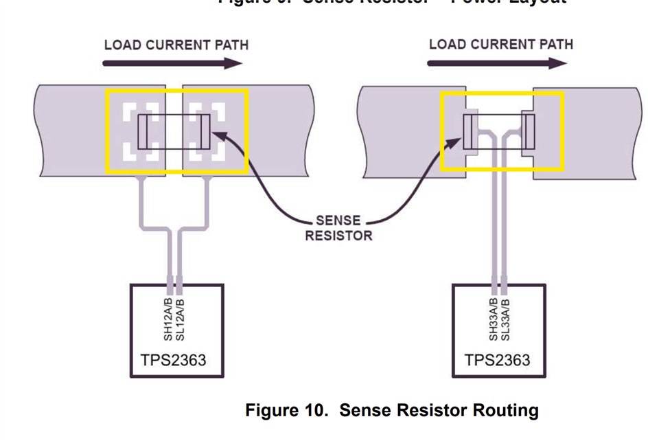

I am looking for more details of the below layout considerations given for TPS2363.
1. Is the connection of sense resistor pads as shown below for 12V (4 side spoke connection) and 3.3V (plane restricted to pads of the resistor) is good to have or must have ?
2. "Connect the high side sense resistor to inner layer power" -- Does it mean the high side of sense resistor pad should be connected only to inner power plane with Via on Pad and avoid plane flood on the same layer as sense resistor placed ?
