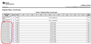

    1. Is it advisable to have Decaps for the LEDs?
    2. We're using individual white LEDs not RGB on 28 channels. I hope the Individual brightness control can be achieved through colour intensity. Please confirm.
    Mukesh
  • Hi Felix,
    I hope the datasheets for the LP50xx series are largely comparable, with no major differences. Is that correct?
    Mukesh
  • Hi Mukesh,
    1. No, no need to place capacitor for output channel;
    2. Yes, each channel brightness can be controlled individually through corresponding OUTx_COLOR register;
    3. Yes, no major differences, except for the channel number.
