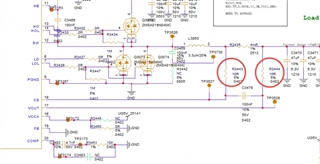

How to measure the Bode of LM25141?  Where to inject interference signals? R3443 or R3444?
  • Hi Xianfeng
    Please upload your full schematic as I can see partial image only. R3443, R3444 are part of current sensing part.
    For measuring BODE, you need to add external feedback divider to measure the loop and test using conventional techniques. The values of feedback resistors do not matter, only the ratio of the feedback resistors matters, effectively the gain from Vout to FB. Please make sure that the Thevenin equivalent impedance of the resistive divider connected to the FB pin must be greater than 5 kΩ to detect the divider.

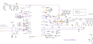

    Attached is the full schematic.
  • Hi Xianfeng,
    Thanks for full schematic. As I have said, you need to install an external feedback divider and test the bode as per usual technique.

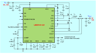

  • Hi, Arpita. According to the LM5141-Q1 EVM User's Guide, the FB pin is connected to ground to get a 5V output. If I need to test the bode, what should I do? Still need to add external feedback divider to FB to get 5V output instead of connecting to ground? Thanks
  • Hi Siv,
    the default setting of J9 [FB connection] is FB is shirted to GND to get 5V output in the EVM.
    As explained above to measure bode, kindly disconnected the short between J9-pin 2 to 3 and place the external dividers. Otherwise, you can find experimental the bode plot given in EVM user guide or you can get the bode using the excel tool itself.
    R20 (RFb2), R22 (Rfb1) can be calculated using the following eq [4] from datasheet or you can use the excel tool attached previously.
