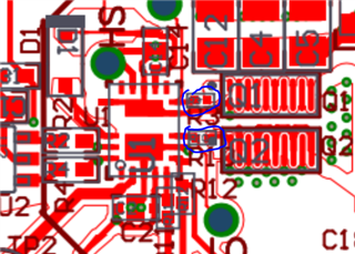

  • Hello Surya,
    The overall layout looks good but I would try and move capacitors C4 and C7 and the gate resistors R11 and R12 and the GaN FETs closer to the driver if possible. This will help reduce PCB parasitics on the critical traces
    In the EVM, the gate resistors are very small 0201 size to make the output traces as short as possible.
    Walter

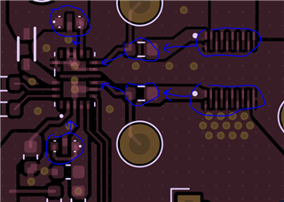

  • Hi Walter
    Thank you for your Review.
    we actually imported footprints of IC and Feed-through capacitors from Samcsys (https://componentsearchengine.com/), which was recommended by Mouser and Arrow electronics for ECAD files.
    Those imported footprints have larger Courtyards, so the colses we could get with C4, C7 and driver is this.
    Below attached is the screen shot from the Kicad PCB showing the Courtyards.
    I believe this bigger Courtyards given by community is needed for ease of Assembly and Re-flow, not sure. so Kept them as it is.
    And regarding the Gate resistors, we intentionally had 0603 because it would be easy to swap them as per needed in the testing.
    If it's really critical for better Gate driving, we shall change them. need your verdict.
    Thank You
    Surya Thanush
  • Hello Surya,
    The current capacitor placement should be fine with the given layout courtyards. 0603 size is fine as well. A smaller size would allow the gate drive path to be made shorter but the current layout should be fine.
    Walter
