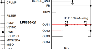

Hi team,
Maximum LED current per channel is 150mA.
For instance, is it possible to set the current for the LED to 300mA by connecting it as shown by the red line in the diagram below?

Hi, Goto
Sure, you can use like that.
