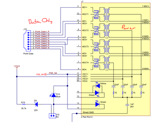

  • Hi Guru,
    When probing the port you should be probing between RJ1_CT0 and RJ1_CT1. This will be your differential, you should not probe these two signal between ground.
    Also, from the schematic, looks like your magnetics or incorrectly wired. Your CMC of the ethernet magnetic should be on your data only side, not your power + data side which is what you currently have.

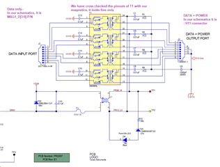

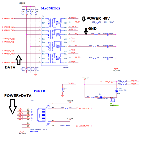

  • Hi Sir,
    Sorry for the late reply. Due to some unavoidable situations, I am unable from my end.
    Regarding the query, please find the below image :
    As per the reference J2, in our schematics it is from the MAG1_D[3:0]P/N
    MAGNETICS is placed correctly
    As per the reference J3, in our schematics it is H11
    Please find the schematics & image below.
    I shall also probe & update you at the earlier.
    Guru

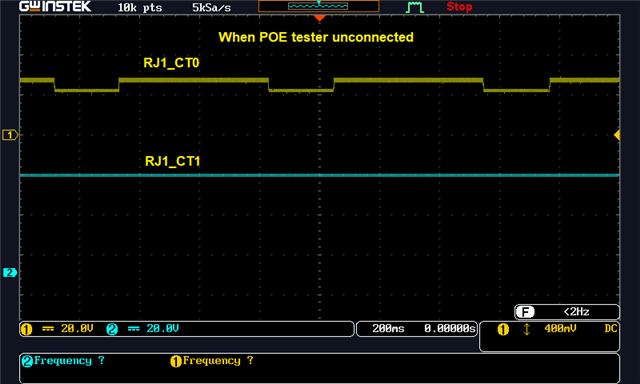

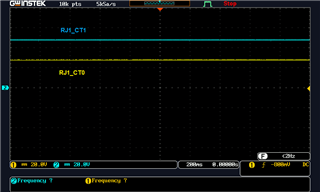

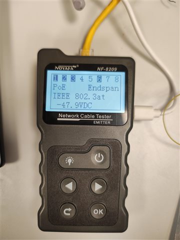

  • Hi Sir,
    Sorry for the late reply. Please find our observations while probing RJ0_CT0 with RJ0_CT1
    We have connected 48V supply & shorted the 12V GND & 48V GND. In open condition, without connecting anything  we found this observation
    Please find the below waveform.
    When we have connected the RJ45 with the POE tester, we found the following observation,
    also in POE tester, we found the following image in POE Tester.
    Please guide us.
    Guru

  • Hi Guru,

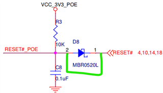

    Please check below items and let me know if it is still not working. Thanks.
    1. The data transformer normally makes the PoE on the side without CM choke. Since the PoE current is CM. Please check with H6096NL vendor.
    2. Bob Smith terminal normally has a >2kV cap between earth GND
    3. /RESET better has a discharge loop. You may short D8.
    4. Please short the unused Kelvin sense to AGND
    5. You can leave OSS open (DNP R4) if you do not have a net connect to PSE_OSS
    Diang
  • Hi Sir,
    We are communicating with the vendor. We shall update you at the earliest.
    Rework done as per the suggestions.

  • Hi Sir,
    H6096NL  supports  4PAIR PoE 75W
    Guru
  • Hi Guru,
    Thanks for your reply.
    1. It is not about the power rating of the data transformer. You may need to know which side (left or right) is for PoE + Data and which side is for Data only.
    Can you get the waveforms of Q1 and Q2's Vds and Vgs when port is open and connected? It seems FETs behaviors are strange.
    Diang

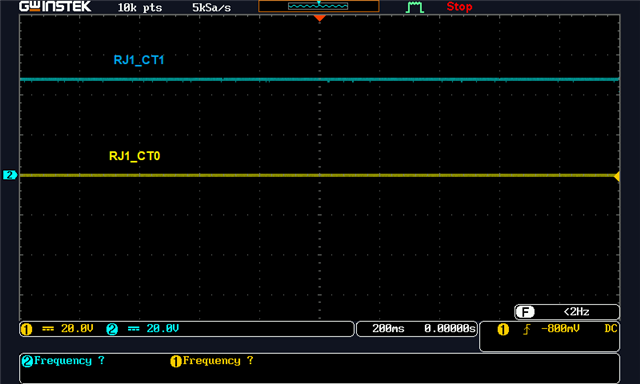

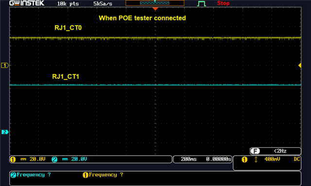

  • Hi Sir,
    Please ignore the earlier waveforms.
    In board we have GND & 48V_GND, The above waveforms are captured without shorting the grounds. Please find the waveforms with shorting the grounds.
    Vg_Vs When POE tester unconnected
    Vg_Vs When POE tester connected
    Vd_Vs When POE tester unconnected
    Vd_Vs When POE tester connected
    RJ1_CT0 & RJ1_CT1 When POE tester unconnected
    RJ1_CT0 & RJ1_CT1 When POE tester connected
    Guru

  • Hi Sir,
    While our debugging, we observed the CDS16403 (Vds = 25V Max) part has been placed.
    As per our circuit the Vds = 48V (Double to capacity of the MOSFET mounted), so we are considering this is the issue, Due to higher Vds, the MOSFET is damaged & Gate junction has been collapsed. So we are getting Vg=0V, Ve=0V.
    We are proceeding for the new Gerber, for the safer side, we shall update it & share the schematics for your reference. Please review & share the feedback.
    We shall share the updated schematics at the earliest.
    Guru
  • Hi Guru,
    I am out of office currently. Will get back to you later. Thanks for patience.
    Diang
  • Hi Guru,
    Thanks for updates. Yes it makes sense that FET Vds rating is the cause of abnormal voltage at the port.
    Diang

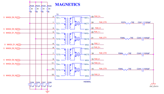

  • Hi Guru,
    You should be able to use 0x20 slave address when A4-1 are ground. Do you have a Saleae waveform about the SDA and SCL at TPS23882B. Also, can you try if you can access the boardcast address?
    See the comments about the schematic but may not be related to the I2C address.
    The data transformer normally makes the PoE on the side without CM choke. Since the PoE current is CM. Please check with H6096NL.
    Diang
  • Hi Sir,
    Please find the screenshot from H6096NL
    The power shall be connected to MCT1/ MCT2 pins.
    So shall we proceed for new Gerber by changing only the MOSFET (considering remaining circuitry is fine)
    Guru
  • Hi Guru,
    I am currently in timebank and will back on Wednesday. Sorry a delay on the replay and thanks for your patience!
    Diang
  • Hi Guru,
    Thanks for your reply. I saw the drawing of CM choke locations are different. The datasheet of H6096NL has CM choke on the pin 1-12 side, and your schematic on the 13-24 side. It is no need to change the data transformer connection except correct the CM locations if necessary.
    Diang
  • Hi Sir,
    Thanks for the confirmation.
    We are updating the symbol (alone) in schematics, so we are keeping the connections as they are.
    Guru
