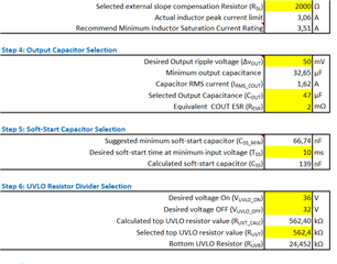

I'm trying to design a boost converter (it's my first time with BOOST converter) to have 142VDC in the output from 45VDC (regulated) in the input, so I was thinking on using the switching controller LM5156.
For this purpose, I used the Excel file for select the passive components and to reach this voltage (see picture below).
Based on the parameters set above I would need help to define the following components:
  1. Characteristics of N Mosfet Q1 -> I used WEBENCH but suggests IDEAL FET with VdsMax= 500.0 V and IdsMax= 100.0 Amps -> I think something with lower characteristics is sufficient, for example VdsMax= 200.0 V and IdsMax= 2.0 Amps -> Could you confirm? If so, do you have a PN to suggest?
  2. Characteristics of DIODE Shotcky D1 -> I used WEBENCH but suggests CUSTOM DIODE with VF@Io= 500.0 mV VRRM= 213.0 V -> I have not found any shotcky diodes with VRRM greater than 213V and with VF equal to 500mV. Can you confirm the need to use shotcky diodes with 500mV? What happens if I use a shotcky diode with higher VF? If so, do you have a PN to suggest?

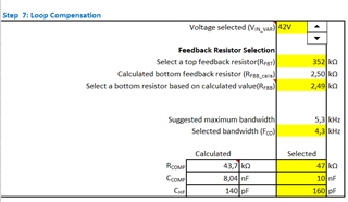

  3. In order to to have 142V output I must use the set of two resistors on rfbt. Could be a problem?
  4. The inductor chosen is SRP2313AA-680M. Could you confirm that it’s okay or suggest an alternative?
  5. Are there any special precautions in choosing the size of the passive components?
Thank you and regards.
  • Hi Andrea,
    Thanks for using the E2E forum.
    1. I would recommend to use the FET with 2* the output voltage of the converter. The Ids should be 2* the peak inductor current of the converter. In your case Ids should be greater than 2 * 4.42 A.
    2. Using the diode with higher forward voltage drop will cause the higher losses in the diode and impact the efficiency of the converter, but the output voltage will still be regulated.
    3. It is not a problem until unless the total resistance is same as of the calculation.
    4. The selected inductor is fine to me.
    5. I would recommend to use 0603 size or smaller
    I recommend to use mouser or Digi key filters to find the parts.
    Hassan
