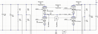

    Here is the power path portion of the schematic that I can share:

    How do you have connected the current sense resistor? Do you use a Kelvin connection? Do you have the required Filter?

    I do not have the current sense filter at the moment. I had a 10 ohm series resistor, and yes with a Thevenin connection, and a 180pF cap. My switching frequency is ~625KHz (Rt is 51K). However, there was a screw up on the BOM and 10Ks were placed instead of 10 ohms so I removed them and the 180pF filter cap. However, when this bad filter was in place before it still regulated to the same setpoint, but it was just VERY erratic.  I have also changed the Vout register value to see if somehow it was latching the mode for the internal feedback network but that didn't change the output so I am fairly sure that isn't what is happening.

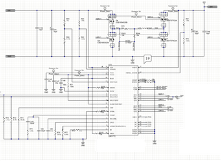

  • I have decided to share the complete schematic of this regulator and just remove the other portions of circuits on the sheet.
    *Notes about the schematic above:
        1) R243 and R244 are 10 ohms on the board, not 10k.
        2) R72 and R74 are not populated.
        3) R77 is really a 0 ohm on the board.
    The cap used for VCC2 is CL31A226MOCLNNC.

    It seems fine to me. If there is anything else I can check I am more than happy. Also, Is there any way to rule in or out the current limit theory?
  • I have found that if I disable PCM in register D9, instead of the bootstrapped setting of enabled at 30%. Replacing R76 on the schematic with a 0 ohm has it now booting up with 24V.
