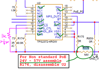

Hello:
The customer has selected LM5116 + TPS2372  for POE project. Please help review the schematic circuit. Thank you!!!
LM5116 now is review in another E2E post. Thanks!!!
4380.05 - PoE PD _ PoE and LM5116 Ma.pdf
LM5116: question about LM5116 - Power management forum - Power management - TI E2E support forums
  • Hi Jimmy,
    Thanks for reaching out!
    TPS2372 should work on your circuit. Two minor concerns:
    1. For 24V - ~38V (UVLO) non standard PoE, TPS2372's hotswap will be bypassed and cannot provide inrush current limiting
    2. The Auto MPS function is not enabled since AMPS_CTL is open. MPS_DUTY configuration won't work too. To have auto MPS please have a resistor at AMPS_CTL
    Diang
