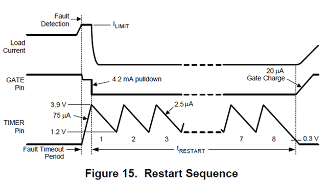

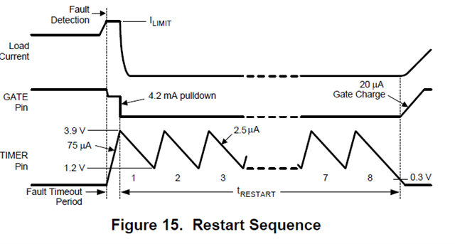

I have a question regarding "8.4.3 Fault Timer and Restart" on the datasheet. The datasheet mentioned "Finer control of the retry behavior can be achieved through the DEVICE_SETUP (D9h) register. Retry counts of 0, 1, 2, 4, 8, 16, or infinite may be selected by setting the appropriate bits in the DEVICE_SETUP (D9h) register." This means users can control the number of mountains and valleys in Figure 15. Is my understanding correct?
