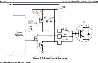

    After testing it, I noticed that the internal resistor at the "OUTH" pin is 2.5 Ω,
    whereas section 9.2.2.5 of the datasheet (Picture 2) specifies it should be 0.7 Ω,

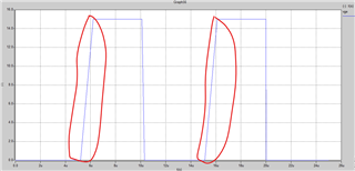

    which results in a slower rising time (as shown in Picture 3).

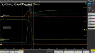

    The datasheet gives a 2.5 Ohm Routh value: I have found that this seems to be a more accurate representation of the device behavior. Here is a double pulse test with the UCC21750 and the C3M0015065D. The output sources Miller plateau current from <2V away from the positive rail, where the NMOS will be in pinch-off. For this reason, I did not include the NMOS in the model for improved simplicity and to aid simulation convergence.
