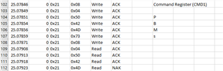

  • Implemented PBMs protocol:
    • Wrote 7-byte bundle descriptor to DATAx registers
    • Wrote CMD1 = 0x01 to initiate PBMs
    • TPS responds with CMD1 = 0x04 consistently (command rejected)
    • DATA1 always shows error (not 0x00)

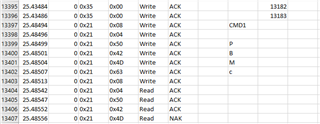

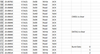

    /cfs-file/__key/communityserver-discussions-components-files/196/cobraPlus_5F00_PMBs_5F00_DBFg.csv

    What exactly does CMD1 = 0x04 indicate during PBMs?
    This is not clear.  It is most likely only the first byte was read which indicates the size.
    After writing the "PBMc" command the CMD register is read until it is cleared.  This is followed by a read of the data to confirm it is cleared followed by a read of the mode to confirm it is in APP mode.
