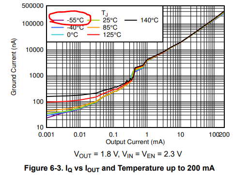

Hello Maharajan,
There is no -55 to 125 temp range version of this LDO, however a lot of the graphs have -55C data provided. For example see below the IQ graph.
Andres
