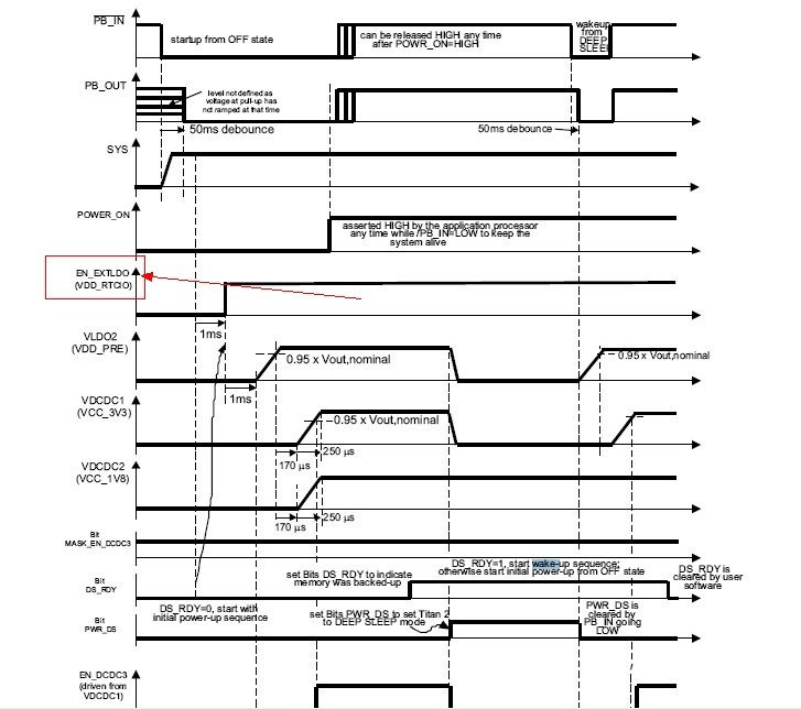

Could you please tell me how to wake up from sleep mode? Our customer have modification the TPS65070 EVM board  by connect the dcdc2 enable to dcdc2  output  to use the external enable function, at the time connect the Pgood to the DCDC1.
Now we find we can not wake up the unit from sleep mode. There is no response when we push the PB_in,  we also can not find the EN_EXTLDO in TPS65070, whats  the EN_EXTLDO use for?
  • How are you putting the device to sleep? When you pull PB_IN low, are you asserting POWER_ON pin high before releasing PB_IN? You said you have EN_DCDC2  tied to DCDC2 output, is that a typo?
    EXT_LDO is the same as VDD_RTC. It is named that way because it is tied to an external LDO as visible in the block diagram associated with the timing diagram you posted.

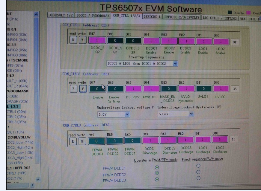

  • customer set the con_crtl2 bit 4 to 1 for the sleep mode.is it any problem here?
    for the EN_DCDC2, we just connect the EN_DCDC2 to DCDC2 outpt with a 10k resistor directely
    Could you please show the details to how to enter into the sleep mode and how to active it?

    Yesterday I have test our TPS65070 EVM Board with customer and find that if we set the  CON_CTRL Bit 7:5 to 100 and CON_CTRL2 bit 5:3 to 110 with all the DCDC Enable IO pin to high,  then the TPS65070 will enter into sleep mode and only the DCDC2 is power on, press the PB_in can wake up all the DCDC output. This result is what we want ,however, I don’t understand the reason, it seems the result not match our datasheet. Could you please tell me why? I want know if there is any problem if we set the EVM like this in our real application.
