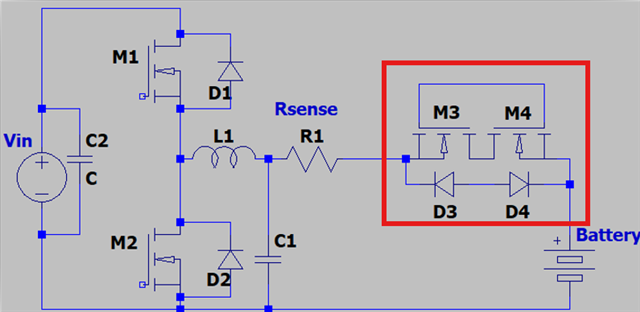

I am planning to place 'back to back connected N channel mosfet in common source configuration' at the output of the synchronous buck converter. I want to replace the output relay with this 'back to back connected Mosfet pair' which is used to cutoff & connect the circuit from the Load. Here, Load is the Battery cell.
You can see attached image for reference.
Also note that, these back to back Mosfet pair will be either continuously ON or continuously OFF (i.e. Similar to relay). And need to drive them on High side.

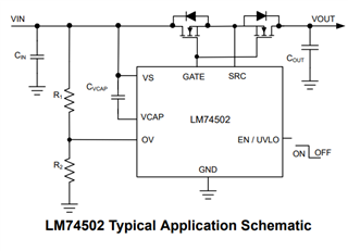

  • Hi C S,
    Yes, LM7502 will be able to drive these FETs.
    Sharing the application schematic for the same.

  • Understood Shiven, But My case is different. Let me explain more clearly.
    Actually, I am going to connect 'N- channel Back to back Mosfet pair' on My Syncronous buck converter Output. The LM74502 will Turn ON and Off the Back to back modfet to connect & disconnect the Buck converter output from the load. The converter is bidirectional so, Load also can supply back to converter, (Here converter work as Synchronous Boost).
    Vout range- 1V to 6V
    Iout~ 20 A
    Now, If I will connect the IC Vs pin to Converter Output, then it will work 11~12 V above that supply, I understand that. But what if Load will supply back to the grid, i.e. Need to connect Converter with Load when Converter output is Zero, because here Load will supply power to converter.
    So, I was thinking to just supply IC from external 5V. So it can Generate Vgs~ 5V+12V=~ 17V, i.e. 5V above the Vs.

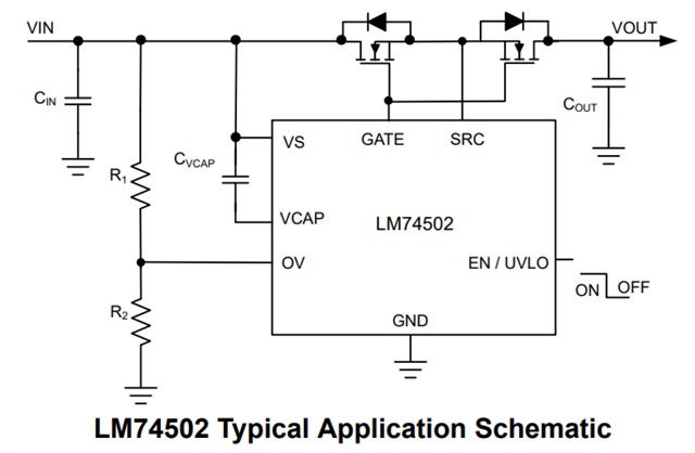

    And what if I need to give direct Bus voltage as IC input- i.e. as per below image-
    It will surely work if direction id from Vin to Vout, but what when direction is reversed?? How IC will work if it is supplied from Vin side??That is main issue i am facing here.

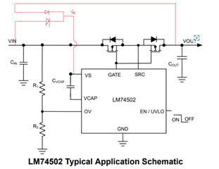

    If you want to power up bidirectionally.

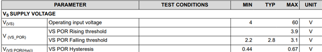

    At VS = 1V, the controller will not work.
    VS rising PORR is 3.9V
