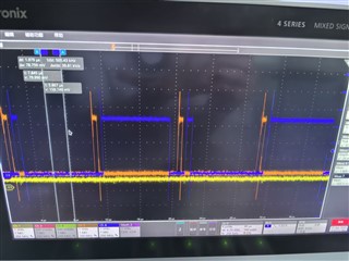

Hello everyone. I have a question and sincerely hope you can help me solve it.I configured the DPWM1 in the following way, operating it in normal mode. I checked the DPWMFILTERDUTYREAD register, which is a constant value, so the waveform should remain unchanged. However, the following situation occurred.

 There will be an abnormal cycle between two normal cycles.Could this have anything to do with CBC? Because it always follows a normal cycle with an abnormal one.
  • We'd love to help but we are unable to debug the issue without more details. For example, what is the device variant? What is the topology? How is your protection circuit designed?
    If you suspect CBC, you can check the current waveform to see if it is too high. I don't think it is due to CBC if the pattern is consistent.
    Just to clarify, this forum is to answer specific questions about the IC itself. System design/debug is often beyond the scope of this forum and I suggest you to contact our local FAE for support.
