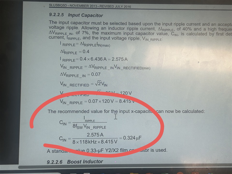

customer wants to know why the calculation of input capacitance needs to be divided by 8. Could u kindly help to answer this? Thanks
