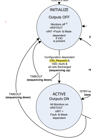

Hi Sathish,
Understood. On the customer's schematic, the EN/PBNSENSE isn't functional. When VSYS rises, the PMIC starts working without needing additional enable controls. If the PMIC freezes or stuck and need restart, the only way to restart it is to restart VSYS. Is that right? If customer design external drive circuit for the PB pin, then they can restart/wake-up the PMIC through external circuit but not Vsys. right?

Hi Rannie,
PB is for initiating the powerup or power down routines of all the output rails.
VSYS is the main power input to the device. With FSD is enabled, device goes thru power up routine each time VSYS goes low to high.
Please look at the device stat diagram on page 51 of, https://www.ti.com/lit/ds/symlink/tps65219.pdf?ts=1745434739673&ref_url=https%253A%252F%252Fwww.ti.com%252Fproduct%252FTPS65219

Hi Sathish,
I noticed that it needs "ON request" from INITIALIZE to ACTIVE. If FSD is enabled, TPS6521910 can enter ACTIVE even if power on Vsys w/o any operation on PB Pin (no ON request), right?
I noticed that in datasheet, the push button is optional not required.
BRs,
Rannie
Hi Rannie,
When FSD is enabled, it ignores the EN/PB on the first power up (VSYS going low to high), so it can enter ACTIVE state w/o any operation on PB pin. ON request is an internal signal and that is taken care of internally.
Push button is only needed when you want to power cycle all the rails.
