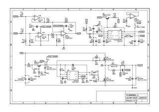

Can you assist this query from customer reporting design for Sync Buck Converter with its specification listed below:
a) VIn = 16V
b) VOut = 4.2V
c) IOut = 3A
d) Fsw = 200KHz
Fig 1: SCH of my Sync Buck Converter

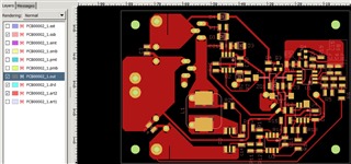

Finally, the graphs below are PCB Top and PCB Bottom
Fig. 5: PCB Top
Fig. 6: PCB Bottom
How to solve issues Q1 and Q2? Thanks a lot.

    1. I suggest you use CT = 1nF and RT = 9k for 200kHz. Your 390pF is not within recommended.
    2. Current sense ringing should be from your board layout. Please highlight your current sense layout traces to help find how to improve.
