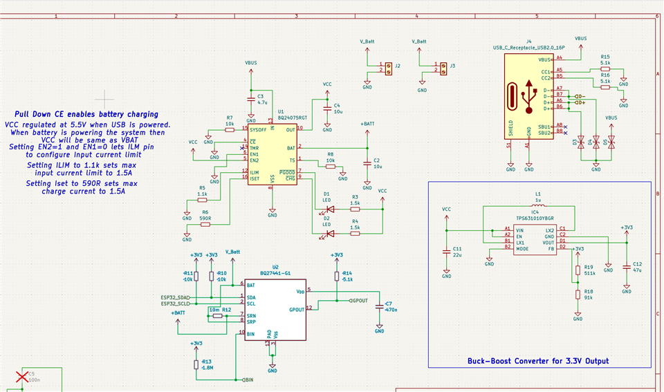

BQ24075: Review Battery Charging IC Schematic
Part Number: BQ24075
Other Parts Discussed in Thread: BQ27441-G1
Please review the BQ24075  Schematic. I am using it with 2X 3.7V nominal 4.2V max 1500mAH Lithium-ion batteries in parallel configuration. I have used it with BQ27441-G1 Fuel cell. I am opening separate thread for fuel cell review aswell.
