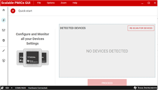

it shows HW connected, but no devices detected

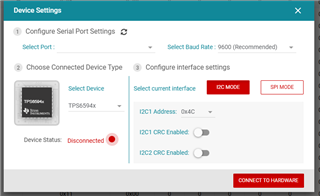

I used default I2C settings, but it does not connect, so I switch to SPI mode on GUI without changing jumper on EVM, connected, but no devices detected.
Can you tell me what is wrong?

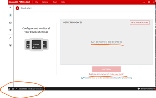

  • here is the message from Scalable PMIC GUI
    can you tell what cause "Duplicate device names (or) invalid name found" error?
    currently it only accepts SPI mode
    how can I switch from SPI to I2C mode on EVM settings while user guide says EVM default is I2C mode
    see below
    any jumper incorrect?

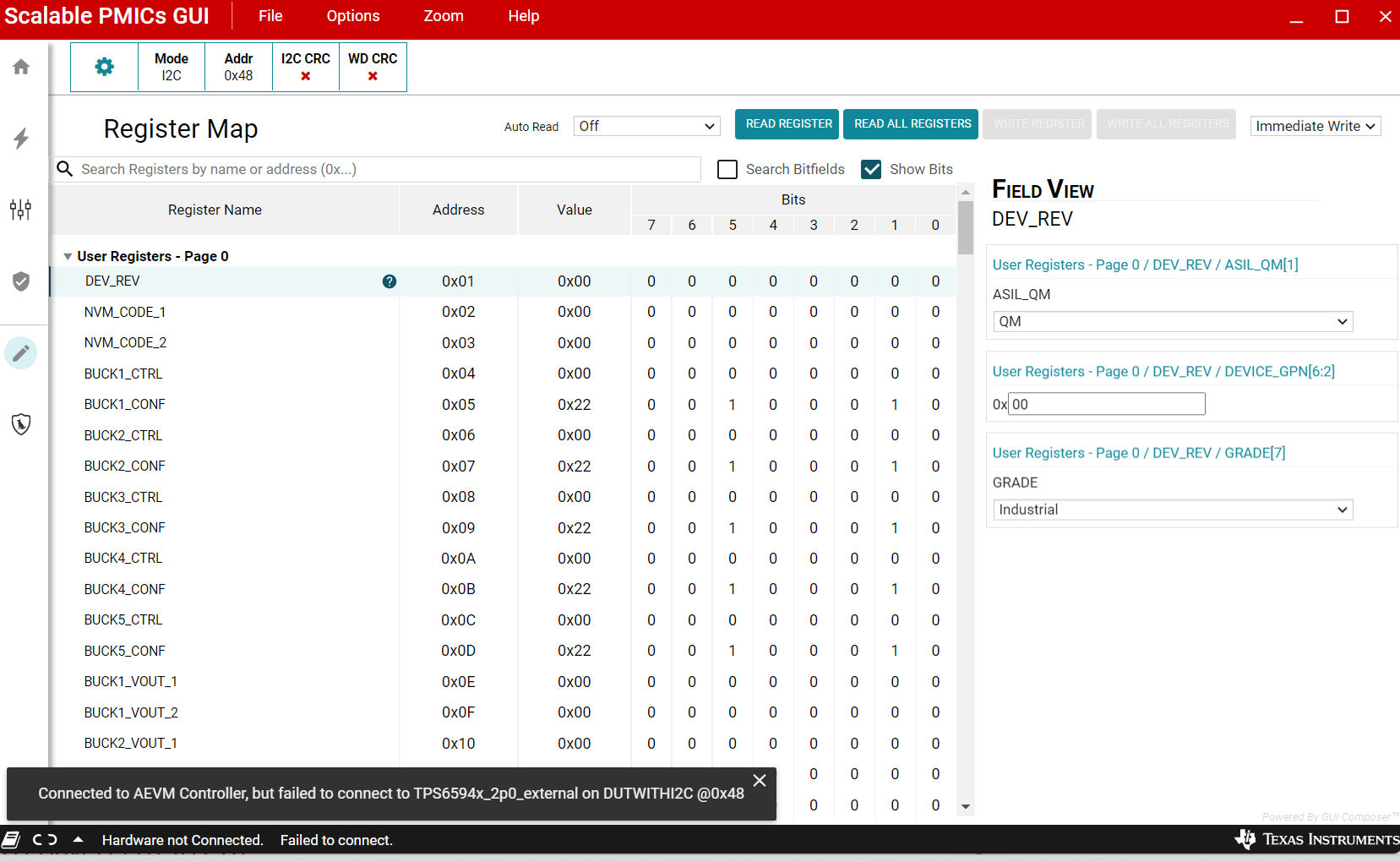

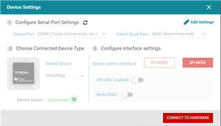

    There is a correct jumper setting, but the PMIC on the device needs to be programmed to work with SPI, as TPS65941111 is on the TPS65941111EVM, this device works as I2C and is expecting to be connected to another PMIC.
    We can go over the details in a call.
    To get started, you can keep all jumpers as they are, but
    1. Remove on of the jumpers on the J8 & J9
    2. Place that jumper on the J15 header, specifically bridge the VSYS & V3V3

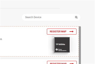

    This will provide power to the PMIC, now click on this when you first get into the GUI, the register map
    Please have these on your device settings
    Confirm the first three registers as something other than 0x00 & that the EVM has connected.

    followed your instructions, here is what I got:
    as you can see Hardware not connected, I tried a few times, it does not connect, I will set a call with you
  • Hi Nick,
    thank you for the support, now the EVM connect the PC with I2C correctly via J47 jumper changed.
