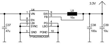

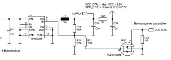

in an earlier revision we were using the TPS62056 (3.3V fixed output). Now we switched to the version with adjustable output TPS62050. We are using the switch converter with a external resistor divider. Using a FET driven by a micro controller one of the resistor values can be changed. So we are able to get 2.7 or 3.3V depending on the FET's state. (see schematics at the end)
The older revision did its work very fine.

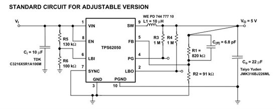

  • the standard circuit (Datasheet page 15, Cff) uses a capacitor Cff with about 6.8pF we don't have in our schematic

Old fixed voltage version
New dual voltage version  (2.7 or 3.3V)

    Your circuit to adjust the output voltage with a FET is fine.  But those 3 resistors and the FET need to be very close to the IC so that the FB pin is not routed all over the board where it can pick up noise.

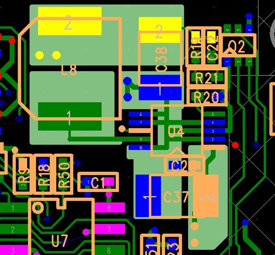

  • Hello Chris

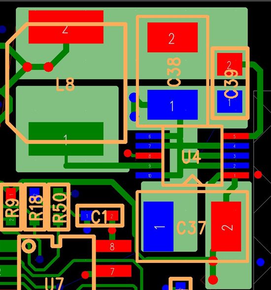

    At the end of this post you will find the requested pictures of the PCB layouts.

    How high is the probability that the IC will not be damaged in a future layout when we change following details of the actual PCB version?
    • Insert a 6.8pF Cff capacitor parallel to R19 (like in the standard circuit)
    • reroute the JTAG TMS signal that it is not close to the supply anymore (see description below the first picture)
    • place a single MOSFet next to R21 to reduce the length of the wire from R21 to Q2

    new version with TPS62050 (dual voltage)
    The net routed between the two pads of R19 is a JTAG TMS signal, which is typically just used for programming the device.

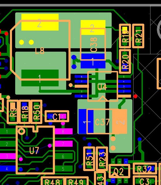

    old version with TPS62056 (fixed voltage)
  • Your layout looks pretty good, except for the trace between the FB resistor and FET as you noted.  Here are some improvements:
    • Make solid pours between C37 and pins 1 and 10.  It looks like you have tiny trace connecting this cap which creates extra inductance and this stress on the device.
    • Move R20 down to the right of the IC, where it can be next to pins 3 and 5 and route directly to those pins.  This changes the return of that resistor to the GND pin (pin 3) and not the output cap.
    • Move R19 and R21 down also to minimize the length of the FB pin net.
    • Make the distance between Q2 and R21 as small as possible.
    To see if it is the layout of that FET and resistor that is causing your circuit to fail, you could simply remove R21 and see if that IC still fails.
    You should also check that during production and test, no voltages in excess of the absolute maximum ratings are being supplied.  What is your Vin to the device and how is it applied normally and in test?

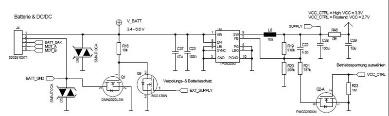

    The device is potential-free and the supply is as already mentioned a battery-package with at most 6.6VDC. Unfortunately there is actually no production test.
    There is a reverse and battery protection between the battery plug and the TPS62050 (Q1 and Q9):
    Due to that fact reverse current should not be the problem. However I've measured it as you told me and there is no problem with reverse current.
    Unfortunately we couldn't reproduce the damage of any further TPS62050 and so not  verify any of your recommended improvements. As you can see in the new schematic we have inserted the 6.8pF cap in the FB path and also planed to use TVS diodes as an ESD protection. An additional 100nF cap (C23) should handle high frequency signals on the voltage input. Your recommended diode in series is already included in our advanced reverse protection (diode in Q1).
    I have redesigned the PCB as you suggested (expect the position of the resistors, because the hatched area on the right-hand side is a keepout for placement).

  • The new layout looks good.
