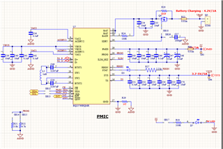

  • Hello Jeff,
    Subject: OTG Mode and Power Source Switching Issues with BQ25798
    We are encountering an issue related to power source switching and OTG mode behavior with the BQ25798 charger IC. Our hardware configuration includes:
    • VAC2 (USB-C input) connected directly to the USB-C port.
    • VAC1 (Solar input) connected via a 5V buck converter output.
    • A Li-ion battery connected to the battery terminals.
    We have configured the charger control register to enable both ACDRV1 and ACDRV2 when OTG mode is required. However, different input scenarios are yielding inconsistent behavior. Below are the detailed cases and the observed issues:
    Case 1: USB-C (VAC2) Connected Initially
    • Setup: USB-C connected to VAC2, and battery connected.
    • Initialization Sequence:
    pData[0] = 0x40; // Enable OTG
    BQ25798_Write(BQ25798_CHARGER_CONTROL_3, pData, 1);
    pData[0] = BQ25798_CHARGER_CONTROL_4_EN_ACDRV2;
    BQ25798_Write(BQ25798_CHARGER_CONTROL_4, pData, 1);
    • Issue: The system operates normally while VAC2 is connected. Once VAC2 is removed and VAC1 is provided instead, enabling OTG causes the voltage at the PMID pin to drop to 0V. The battery also stops charging.
    Case 2: Solar Input (VAC1) Connected Initially
    • Setup: Solar buck output connected to VAC1, and battery connected.
    pData[0] = BQ25798_CHARGER_CONTROL_4_EN_ACDRV1;
    • Issue: The system functions correctly with VAC1. However, if VAC1 is removed and VAC2 (USB-C) is connected instead, enabling OTG again results in PMID dropping to 0V, and the battery stops charging.
    Case 3: Both VAC1 (Solar) and VAC2 (USB-C) Connected
    • Setup: Both solar and USB-C power sources are connected along with the battery.
    pData[0] = BQ25798_CHARGER_CONTROL_4_EN_ACDRV1 | BQ25798_CHARGER_CONTROL_4_EN_ACDRV2;
    • Issue: When both power sources are connected, the device works fine. However, when both VAC1 and VAC2 are disconnected and only the battery remains, OTG mode fails to provide 5V on the PMID pin. The PMID remains at 0V. If only one of ACDRV1 or ACDRV2 was previously enabled (not both), the OTG function correctly boosts the battery voltage to 5V at PMID.
    Request
    We would appreciate guidance on:
    1. Why enabling both ACDRV1 and ACDRV2 causes PMID to drop to 0V when only the battery is present.
    2. The correct way to configure ACDRV1/2 and OTG mode to ensure reliable behavior across different power source transitions.
    Thank you for your support.

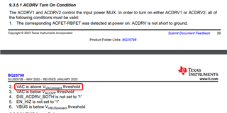

  • Hi Parth,
    Regarding 1, the charger does not allow both ACDRx to be enabled at the same time.  So it turns both off.
    Regarding 2, the host must first write EN_OTG then write EN_ACDRV1 or EN_ACDRV2 for the OTG output to turn on.
    Jeff

  • Hello Jeff,
    We’re using the BQ25798 charger IC in a system with the following setup:
    • VAC1: 5V from a Solar Buck Converter
    • VAC2: USB-C input (5V only)
    • Battery: 1-cell Li-ion (3.7V-4.2V)
    • OTG mode: Used to boost battery voltage to 5V at PMID
    We are facing issues related to power source switching and OTG behavior based on ACDRV configuration. Here’s what we’re observing:
     Case 1: Configured for VAC2 (ACDRV2 enabled)
    • VAC2 present → System works perfectly: battery charges, PMID has 5V, OTG works.
    • VAC2 unplugged, VAC1 applied → System does not work: PMID stays low, battery doesn’t charge.
     Case 2: Configured for VAC1 (ACDRV1 enabled)
    • VAC1 present → Works fine.
    • VAC1 unplugged, VAC2 applied → Doesn’t work: same issue as above.
     Case 3: Configured for both VAC1 and VAC2 (both ACDRVs enabled)
    • Any one or both inputs connected → System works fine.
    • When both VAC1 and VAC2 are unplugged (battery-only) → OTG mode fails:
      • PMID = 0V
      • Battery is present, but the boost function does not activate.
     Summary of the Problem:
    • The PMIC works perfectly when only one ACDRV (VAC1 or VAC2) is enabled and the corresponding input is used.
    • If we configure both ACDRVs, it supports both inputs — but in battery-only mode, OTG mode fails to generate 5V on PMID.
    • It seems the PMIC may be attempting to boost through both input paths, which are disconnected, and it fails to deliver PMID output.
     What We Need Help With:
    • Why does enabling both ACDRVs prevent OTG mode from working when no input source is present?
    • Is there a recommended way to handle dynamic input switching so that the charger can:
      • Accept either VAC1 or VAC2 when connected,
      • And still properly support battery-only OTG operation?
    We appreciate any suggestions or application notes on how to manage ACDRV control during such transitions.
    PMIC Config Power Source Present Behavior
    Configured for VAC2 only VAC2 present  Works fine
    Configured for VAC2 only VAC1 present  No PMID, no charging
    Configured for VAC1 only VAC1 present  Works fine
    Configured for VAC1 only VAC2 present  No PMID, no charging
    Configured for VAC1 + VAC2 Either or both inputs  Works fine
    Configured for VAC1 + VAC2 No inputs, only battery  No 5V OTG at PMID
  • Hi Parth,
    First, enabling both ACDRV1 and ACDRV2 is not allowed, ever. So I do not understand Case 3. If there are two valid inputs at VACx, VAC1 has priority. The host can I2C write EN_ACDRVx=0 and EN_ACDRVy=1.  If the input on VACx goes below UVLO or triggers poor source, ACDRVy automatically turns on.
    When MUX FETs are present, EN_OTG=1  only completes after one EN_ACDRVx is set to 1 per table below.  But if you first set DIS_ACDRV=1 and then set EN_OTG=1, OTG will turn on.
    Jeff
