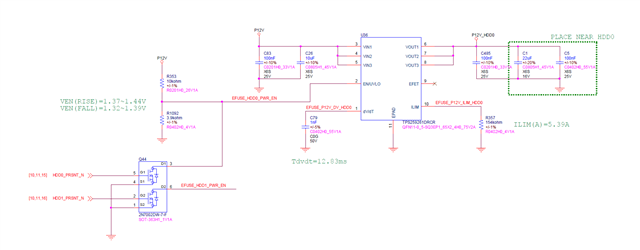

Hello TI team,
The customer is using the TPS259261DRCR. Please help review the schematic
Hello TI team,
Hi Gary,
The schematic looks fine. We recommend transient protection if end applications is expected to have high slew rates due to events like hot-plugging or short circuit.
