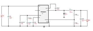

Customer would like to use TPS54531 for Vin=12V, Vout=7V/3A. The inductor they used was 15uH.
Could you please help calculate the compensation component values for them?
Hi Aki Li,
You can use webench tool to calculate the component values:
https://webench.ti.com/power-designer/switching-regulator?powerSupply=0
For your application, you can use these components:
