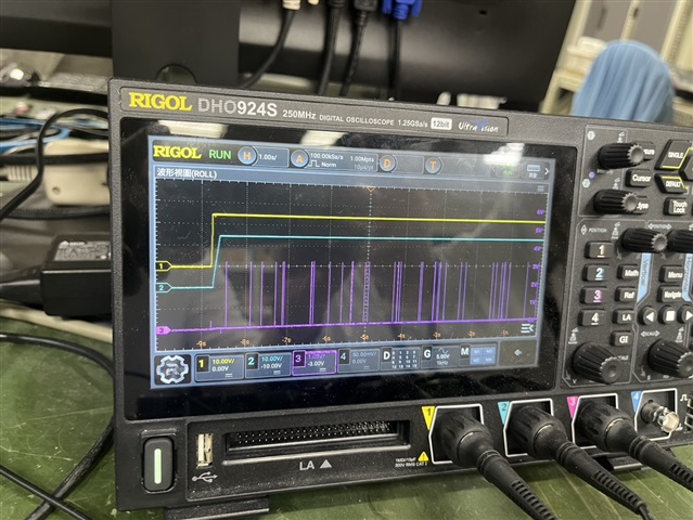

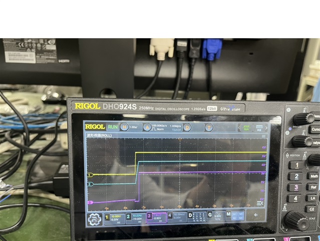

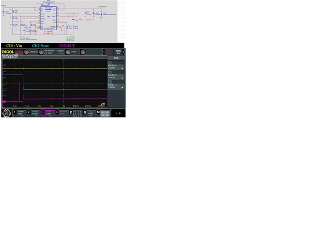

The TPS26400RHFR eFuse will not automatically recover after the output is short-circuited.
MODE is set to OPEN breaker with auto-retry.
Test method: Use a multimeter to measure and confirm that there is output power, use a multi-core wire to short-circuit the positive pole and the ground, then use a multimeter to measure that there is no power output, and use the software to detect that the eFuse status is Fail.
The schematic is as follows:
