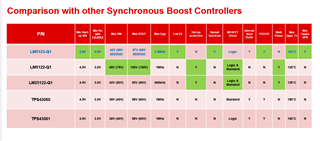

I am currently working on a design that requires an automotive-qualified boost controller to convert an input of 12V nominal (with cold crank support) to an output of 36V @ 12A. The key requirements are:
Input Voltage: 12V nominal (must support cold crank, down to ~6V–7V)
Output Voltage: 36V
Output Current: 12A
Automotive Qualification: AEC-Q100 or equivalent
Small Form Factor: PCB space is a constraint
While reviewing TI's portfolio, I found the LM51231-Q1 and LM25122-Q1, which appear to be suitable for the application. I would appreciate your insights on the following:
  1. Which of these devices would be more optimal for this use case, considering cold crank support, high output current, thermal and efficiency performance?
  2. Is there a better recommendation within TI's lineup that offers improved integration or smaller footprint?
  3. Any available design resources or reference designs that align with these specifications?
Looking forward to your guidance and support.

  • Hi Vinod,
    Thank you for using e2e form.
    Both LM51231-Q1 and LM25122-Q1 are the good fit here. You can check the below image for the differences between the two devices.
    I found the reference design that matches your specs. I believe it is for the Audio application. Please check this https://www.ti.com/tool/PMP11769

  • Hi Mounika,
    Thank you for the response and for sharing the comparison between LM51231-Q1 and LM25122-Q1.
    We are specifically targeting a design with a 36V output at 12A, powered from a 12V vehicle battery. While we understand that both parts are boost controllers and that the output current is largely determined by the selection of external MOSFETs and inductors, we’d like to confirm whether either of these controllers can support the required duty cycle for this application. Could you also help clarify any limitations on the maximum duty cycle or current handling constraints of these controllers in such a setup?
    Thanks and Regards
    Vinod J
    Mistral Solutions
  • Hi Vinod,
    Regarding the Duty cycle limitation from 12V to 36V, I belive there is no issue. I have also attached the DC limit for both devices below. Like you mentioned for the current handling in controllers it is the MOSFET and inductor selection. Additionally LM25122-Q1 has multiphase capability. However, if you want to use the single controller then LM51231-Q1 can be used as well.
    LM51231-Q1
    LM25122-Q1
    Please let me know if you have other questions.
    Mounika
