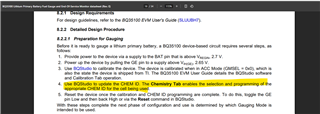

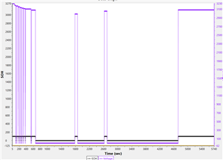

  • As shown in the first image, I selected the CR123A battery from Duracell, which is exactly the one I'm currently using. I'm cycling the GE pin by manually removing and reinserting the GE jumper on the BQ35100EVM. However, as seen in the second image, the SOH value remains unchanged—whether the relaxation period is short or long. I’m discharging the battery with a constant 30 mA load.
    I’m unsure what the minimum required relaxation time is for this discharge current, and I’d also like to confirm the maximum allowed current draw during the relaxation period.

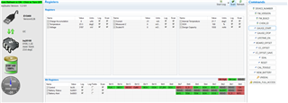

    Additionally, as shown in the third image, the values for measured Z and scaled R are always 0, and the SOH stays at 100%. However, I do observe a sudden drop in SOH when I reset the IC.
  • The CR123A from Duracell is Mno2. Please use the SOH mode (not the EOS mode) for this chemistry. See TRM, 5.2.
    The gauge uses relaxed voltages only for this type of chemistry. It won't use Z and R. Make sure that the load is not on (or minimal, like C/25 or less) when you assert the GE pin.
  • Thank you for the answer. I am using SOH, not EOS. What do you mean by C/25? Do you mean 1/25 of the load?
    The C in C/25 refers to the capacity of the battery pack. Please discharge at 1/25 the battery pack capacity.
    Diego
