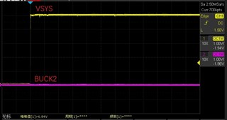

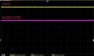

    Thanks for your reply!  According to your advice, my customer changed their design of MODE/STBY pin with a 6.8k pullup resistor as below:

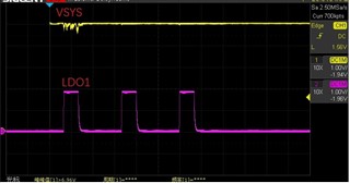

    VSYS=5V, The waveform of VSYS and MODE/STBY is in below pic:

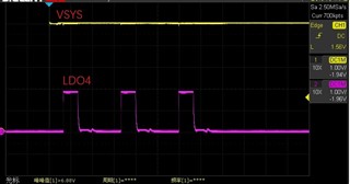

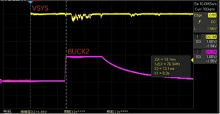

    The other output pin waveforms are:
    But in BUCK2, there is still no output. Could you help check the issue?

  • Hi Moon,
    Thank you for the waveforms.
    As you can see Buck2 output is set to 3.3V but it can only go up to ~1.8V and as it comes up there is a disturbance on VSYS.
    On the schematic Buck2 output (LX_B2) is also labeled as SW_VCC_1P8. Can you please ask the customer where is it connected? Similarly it is done for the remaining Bucks. The LX side of the inductor should not be connected to anything.
