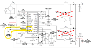

I'm designing a 6.6kW interleaved CCM Boost PFC using UCC28070APWR.
I’m using Allegro’s Hall-effect current sensor ACS756 to feeding its output (via resistor divider and LPF) into CSA and CSB pins for the current loop.
The setup is as follows:

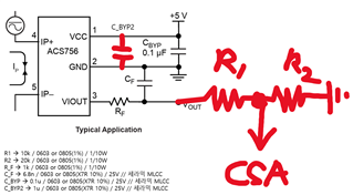

- ACS756 has a 2.5V reference and 40mV/A sensitivity.
- For ±50A range → output spans 0.5V ~ 4.5V.
- I use a resistor divider (10k:20k) to scale the 4.5V max down to 3V max at CSA/CSB.
- There's also a 1k + (1uF, 0.1uF, 6.8nF) to suppress switching noise before reaching CSA.

I’m attaching a schematic snippet for reference (see below). Please let me know if this approach is acceptable or risky in any specific way.

  • Hello Ki,
    I have no experience with the ACS756 Hall-effect sensor, however, after scanning through its datasheet I have the following concerns and observations:
    1.  It's bandwidth is limited to ~120kHz, so it will not reproduce the switch current cleanly for narrow duty cycles.  Also, it has a ~1us propagation delay and ~3us rise time which will affect narrow pulses significantly.  At best, this can lead to higher distortion at high-line peaks.  At worst, it may prevent detection of excessive peak currents until they become destructive, depending on certain fault conditions.
    2.  The 0.5V output offset at 0A will probably introduce significant dead time at the AC-line zero-crossing, making THDi even worse.  IF you can level-shift most of this out, it would be helpful.
    3.  In control systems, time delays introduce a lagging loop phase shift (closer toward 180 degrees) so loop stability can be significantly affected unless phase lead can be obtained to counteract it.   Excessive R-C filter time constants introduce additional signal delays which make this problem worse.  Minimize R-C filtering to only what is absolutely necessary.
    4.  I do recommend adjusting PKLMT to match the actual peak signal at which you want the limiting to apply.  PKLMT is not a fixed level.  It is intended to be varied as needed in each design according to the peak current where limiting is expected.
    I am not saying that this Hall-effect sensor scheme cannot be made to work.  I am saying that there are limitations to this particular sensing device that must be accepted or compensated to achieve reasonable PFC performance.
