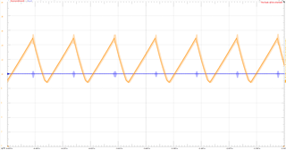

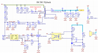

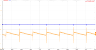

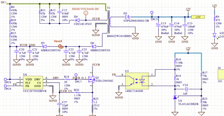

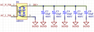

I am attempting to use the UCC287502DBVR in order to generate 12V max 2A.  When I plug in my PCB, I get 0V out at the output.  Voltage (carefully) measured after the bridge rectifier is ~172VDC, and the VDD pin on the UCC287502DBVR drops from ~12.5VDC to ~9.5VDC before jumping back to ~12.5VDC.  Below is the schematic for my PCB.
