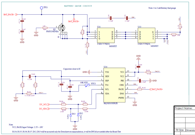

We are using BQ28Z620DRZR Gauge IC in our design for 3.6V single Li-Ion cell input.
1) When I am connecting single battery Li-Ion Cell 3.6V to the IC BQ28Z620DRZR VC1, VC2 pins, the CHG FET is ON, but DSG FET is OFF and voltage is not flowing to PACK input side, so in this case voltage is not flowing to loads such as like MCU, and other loads, etc.
But When I am connecting 3.6V to the PACK input side, both CHG FET & DSG FETs are ON. But in real-time not possible to connect like this, In this case how can we ON both CHG FET & DSG FETs through ICs VC1, VC2 single cell input voltage?
attached circuit for reference
2) When we are using BQStudio for single battery cell calibration the INIT BIT is always ON. we need your input for how can we modify the INIT bit to LOW.
Any help is greatly appreciated.

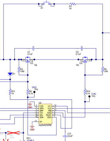

    We have three different boards, and the same issues are occurring on all three. I don't think this is a DSG FET gate issue. The DSG FET only conducts when we apply power to the IC PACK pin. That is why the BQ28Z620DRZR EVM board has an S1 switch to power the IC PACK pin initially. Without the S1 switch on the EVM board, the IC PACK pin won't power on, and cell voltage won't flow to PACK+ to any loads. If you have a BQ28Z620DRZR evaluation board, please test the same scenario using only cell voltage power input and not any external power to the PACK pin, and do not apply S1 voltage to the IC PACK pin, and cell voltage won't flow to PACK+ to any loads.
    attached EVM board schematic FYI.
    Thangapandi
    Yes, to wake the device, you must apply a voltage on pack when the gauge is power cycled. This is done on the EVN through S1, that is you momentarily apply a voltage at PACK through the battery to wake the gauge. The operation in which you must apply a voltage on PACK to wake the gauge is described in the Datasheet.
    Jonny.
    In this case how it is possible to apply Li-Ion cell voltage to Pack pin, because we have only Li-Ion cell input power in the final product with enclosed product option, in this condition not possible to add any switch also for momentarily apply a voltage at PACK pin.
    Do you have any suggestions and any reference circuit for resolving this issues. Because this is urgent basis project, and we need to send sample boards to customer ASAP.
    Thangapandi.
  • Hello Thangapandi,
    You do not necessarily need a switch or button to connect PACK with BAT to apply a voltage on PACK to wake the gauge. Instead this can simply be accomplished by applying a charger on PACK.
