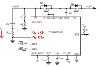

I have two questions about TPS4810-Q1, please kindly help confirm:
1) If I set low-side current sense configuration(CS_SEL is pulled to high) for TPS4810-Q1, can it support bidirectional current detection(From CS+ to CS- or From CS- to CS+)?

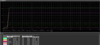

2) I used the PSPICE model of TPS4810-Q1 to simulate, found V(BST-SRC) reached to 15V, is it OK?  I think it should be between 9.3V~12.8V  from the datasheet.
