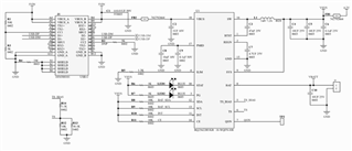

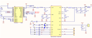

i attach the my design of BQ25622 , here when i connected the vbus to 5v source then BQ25622 ic will heated up too much ,help me to fixed this is this right design or i have to modified it if yes then provide suggestion
  • Hi Ravi,
    I have reviewed your schematic and have the following comments.
    -Can you please help to explain the reason for your selection of 220 ohm resistors for pullup for STAT and PG pins? Generally speaking TI recommends using at least 1kohm or larger resistors for these pins as they are not designed to be able to sink a large amount of current.
    -Pullup resistor connected to INT pin is recommended to be 10kohm.
    -Please be aware to enable charging you need to be able to pull /CE pin low. Your schematic only shows /CE connected to 3.3V pullup.
    -Please be aware if you are to leave TS pin unconnected you need to set TS_IGNORE = 1 (REG0x1A[7]) to be able to charge your battery.
    Besides these comments the rest of the schematic looks okay.
    Can you please help to quantify this statement? What is the current draw at VBUS when you observe the PCB heating up? How much is the IC heating? If you do not have a way to measure heat can you please use the integrated ADC of the BQ25622. The TDIE ADC output (REG0x36) will provide a close estimate of the IC temperature.
    Garrett
  • hello @garrett thanks for your replay ,here i made the change which u suggest like  (1)give 1kohm in STAT and PG PIN , (2)  10kohm pull up on INT (3) pull down on CE by 3.3kohm but it did not slove problem ,is VBUS is compalsory to activate ic
  • Hi Ravi,
    Thank you for implementing the recommended changes.
    I will require a waveform of VBUS, IBUS, etc or data to show the IC heating you are observing to be able to move forward with further debug. At this point in time nothing from the schematic alone indicates why you are seeing overheating issues.
    Garrett

  • hello @garrett ,i update my schematics after changed as per evm schematics. here i give 5v to vbus battery is not connected getting vsys=3.7v and led on pg pin is on and i2c detected, after sometime around 10min led on pg pin turn off measured vbus=5v, vsys=0, i2c not able to detect .
    on same IC battery connected ,vbat =3.9v ,vsys=3.9v i2c vbus is not there and i2c detected .
    above two situation CE is is high.
    here i am not able to understand here my IC is damaged or some of IC peripheral are damaged. if in this case nothing damaged then why i didn't get vsys when vbus=5v. and if IC damaged then why IC able to communicate via i2c when Vbat is appply by battery.
    still confused ,how to communicate with IC via i2c when both vbus and battery is present in this case my IC get overheated and damaged.
    give us proper guide do work with this IC proparly.
  • Hi Ravi,
    I see no clear issues in the updated schematic. Regarding your question on damage, it is possible for part of the IC to become damaged while other aspects still function. For example, I have seen input side damage before which prevents proper converter operation, but the I2C block of the device still functioned normally.
    The issues you are observing continue to point to a layout or soldering issue considering there is no issue with your schematic and you appear to see overheating/damage even without charge enabled.

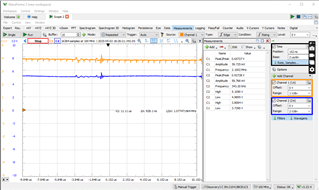

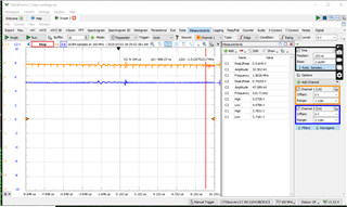

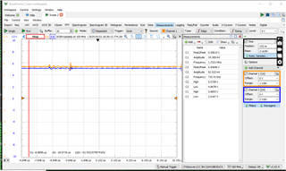

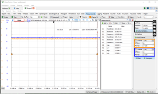

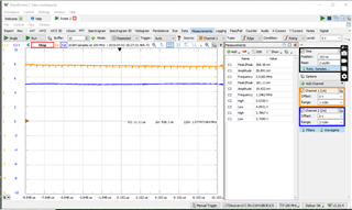

  • hello @garratt , here as you want to see waveform of VBUS,SW,VSYS,VBAT provided below.
    (1) VBUS and SW when CE IS high
    (2) VBUS and VBAT when CE IS high
    (3) VBUS and VSYS when CE is high
    (4) VBUS and SW when CE is low
    (5) VBUS and VBAT when CE is low
    (6) VBUS and VSYS when CE is low
    here CHANNEL-2(blue) is VBUS and other is alternative.

  • Hi Ravi,
    VBAT = 2.5V with no battery present is not expected for either CE high or CE low case. When CE is high and nothing is connected at BAT expected voltage is 0V. When CE is low and no battery is present BQ25622 is expected to charge BAT pin output cap up to 4.2V.
    Observing 2.5V at BAT pin with charge disabled would indicate there is some leakage path in your hardware setup.
    In the waveform which includes SW expectation is SW voltage should be transitioning between 5V and 0V, similar to what is shown in Figure 9-10 in the BQ25622 datasheet. If you use a smaller time division are you able to see expected SW waveform?

  • Hi Ravi,
    Please see my comments below.
    1) The battery monitoring ADC of the BQ25622 device is offered as an extra feature in addition to the regular charger and is for reference only, and therefore does not have accuracy specs. If your system requires highly accurate ADC measurements use of a battery gauge device is recommended. With that in mind observed difference of approx. 0.025V between ADC output and multimeter measurement is not unexpected.
    when the battery voltage goes below the 2.9v adc stop reading data
    Referring to the 'Integrated 12-bit ADC for Monitoring' section of the datasheet (Section 8.3.7) when in battery only operation the battery voltage must be above Vbat_lowv voltage threshold for ADC operation. ADC will turn off when battery voltage drops below this threshold. Vbat_lowv threshold is typical 2.8V and maximum spec of 2.9V. Given this the ADC stopping is expected.
    what is the value to Vref for ADC
    2) Unfortunately, I cannot share such details as it is proprietary.
    thirdly, we still not get proper answer why when we connect battery and vbus together our IC got damaged.
    3)The intended operation of the BQ25622 IC is to have both input connected at VBUS and battery connected at BAT pin. This use case has been thoroughly validated by TI, works as expected on the BQ25622EVM board, and has been used by a variety of customers without issue.
    Given I see no issues with your most recent schematic the damage you are observing is almost certainly due to board layout or test hardware setup. Have you used your oscilloscope to attempt to capture waveforms of power signals at time when IC gets damaged in your test? Are you seeing abnormal current draw at either VBUS or BAT in the leadup to observed damage?
    Garrett

  • Hi Ravi,
    2) why u cant tell about vref ,without knowing vref how we can identified whether our value correct or not.
    Allow me to clarify. The VBAT ADC is measuring the same voltage as observed at the BAT pin of the BQ25622. The battery voltage measurement for the ADC is taken at the Q4 BATFET internal to the IC. Please measure voltage as close as possible to BAT pin of the IC as reference to compare to VBAT_ADC output.
    3) why diffrence between actual value(vbat measured by multimeter) and ADC value are change as load increase on vsys.
    If you are measuring by multimeter at the battery terminals the difference will increase as load increases due to voltage drop along the trace and wires between BAT pin and actual battery terminals. A higher current through the path leads to larger voltage drop.
    Garrett

  • Hi Ravi,
    Firstly, great to hear you resolved your issue regarding IC heating.
    Now to address your report of not charging can you please try the following experiment. Please test if BAT pin output voltage will increase to approx. 4.2V with charge enabled and no battery actually connected?
    Expectation is BQ25622 will charge the 10 uF output capacitor at BAT to 4.2V, then charge will terminate, voltage will decay some and then charge up to 4.2V again similar to the waveform capture shown below.
    If BQ25622 works as expected in this test then it confirms all IC configuration is okay and there is something specifically related to your battery pack preventing charge.
    Garrett
