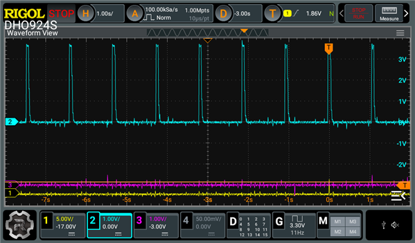

- the frequency of the oscillation increases when we sample the NTC fault more frequently (this is not the I2C frequency). For instance, sampling 5 times per second causes the NTC fault to oscillate with a 1s period. Sampling it only twice per second results in an oscillating period of ≈5 seconds. The INT and STAT pins also oscillate (see the first two images below), with varying duty cycles. STAT sometimes fades away and stops pulsing (duty cycle drops to 0%), while the issue still persists, making the STAT output unusable for our application. Since the jumpers are configured to force NTC to "hot", we expected to read "NTC hot" continuously and for the STAT pin to blink at 1Hz (as described in §9.2.16.7 and Table 5).

Captures of the logic analyzer output on the BQ25896-EVM664: Channel 0 & 1 are I2C, channel 2 is INT pin, channel 3 is STAT pin.
What was obtained while the battery was plugged: INT pulses, in sync with the oscillation of the NTC fault observed
What was obtained in the same situation, while the battery was unplugged:

    I took some voltage measurements of VREGN and VTS.
    Channel 2 (blue) represents VREGN, and Channel 3 (magenta) represents VTS, with a scale of 1 V per division.
    The first channel (yellow) shows a pulse when the first correct NTC fault value is returned ("hot" or "cold", depending on the test case) after 10 seconds of communication (so you can see what the signals look like over a longer period). Afterward, the next few values read as "normal", which is not the expected one in either test case.
    I have attached the raw waveform files if you want to take a closer look.
    I also included the logic analyzer output (DSView). The first two channels are the I2C lines, and the third is the INT pin. Channel 4 is STAT. Channel 5 is unused, and channel 6 shows the same pulse as the first channel on the oscilloscope, for synchronization.
    Best regards.
