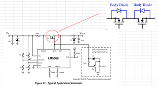

Which configuration is better for providing reverse current blocking function?
1. Change to Bi-Directional circuit (FET)
2. Add LM5050 and FET
1.
2.

Thanks for reaching out.
This option only provides the reverse current blocking functionality during off condition. LM5069 controller doesn't turn off its gate during the flow of reverse current.
This should be used for true reverse current blocking. Below reference design might be followed.
