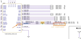

Hi TI support team,
I'm LCFC EE-Dave, my TI FAE window-Allen Lin(allenlin1028@ti.com) suggest me to use TI E2E website for TI design question.
LCFC CS26 T14s AMD GEN7 project
Platform : AMD Gorgon(FP8)
Re-Driver : TUSB1044
PD : TPS66993
Block diagram as below :
Schematic link as below :
LCFC T14s AMD GEN7_Schematic
LCFC design question :
1. page7,  pin23 CTL1 of TUSB1044, need to reserve connect to what's signal or NC?
2. page8, pin27 P0_GPIO13/PA_HPD_RX of TPS66993, need to connect to what's signal or NC?
Please help to reply my design question, thanks.
