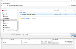

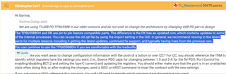

  • Hi Nitish,
    As mentioned in the previous thread, you can use the same PJT for the two devices, but the binary generation is slightly different.
    The DH and DK versions of the TPS65988x have different base FW versions, with the DH having the F707 versioning and DK having the F907 versioning.
    To get the GUI in the correct version, open any default TPS65988DK project. Then go to Project->Import Settings from project, and select your old project file.
    Now, the GUI should have a TPS65988DK project with your old settings applied.
    I made a copy of your pjt with imported settings following the steps above: TPS65988DK_IMPORTSETTINGS.pjt
    The same binary will not work on both due to the difference in base FW.

  • Hi Chris
    Thanks for the new PJT.
    We tried to generate the binary from the PJT file you shared, but it does not detect the RTL8153 to the opposite typeC device and only charging is happening.

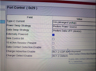

    Both of your ports are set to be DFP only, and support "process swap to UFP" but will not initiate swaps to UFP. This means that the RTL8153 will only become DFP if it initiates a data role swap.
    If you want to change this, you can select the "initiate swap to UFP" option in the "port control" register, and the port will prefer the UFP role and initiate the DR swap from the TPS65988 port if a DFP.

    Please suggest where to mention the data role in DK part. Below is the snap from ACT tool for DH part.
    The power and data options both settings we need in DK part as they are in DH.
    nitish
  • Hi Nitish,
    Which version of the GUI are you using? Are you using the PJT is shared with you?
    In Port Config, the Port Config is set to DFP only, this will control the initial connection and force it to be DFP/Source only. This may be fine.
    In Port Control, you may want to enable the "Initiate swap to UFP" bit if the port prefers being data UFP.
    Thanks and Regards,
    Chris

  • Hi Chris
    Yes, we load the PJT directly in GUI.
    We followed the steps as you suggested for initiate swap to UFP and it worked successfully and this helped to resolve our issues.
