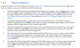

  • Hi, some follow up questions.
    1. Do I need to set the Transmit Sink Capability Register, or can I just leave that? What is the difference between Variable vs Sink PPS/AVS?
    2. I cannot find a good specification of how to translate Receive Source Capability Register, other than the USBCPD Application Customization Tool TX Sink Capabilities, is there a good overview you could guide me to?
    3. If the source is non PPS/AVS, how do I set the voltage? Do I still just set PPS/AVS to eg. 9V/48V? I cannot find anywhere where I would request a specific PDO profile.
  • Hi Richard,
    Yes, the Transmit Sink Capability Register should be set. The difference between these power supplies is defined in the USB PD Specification (see below):
    The Source Capabilities Message structure is defined in the USB PD Specification as well.
    The voltage/current levels along with the type of power supply supported should be set in Transmit Sink Capabilities Register.
    Aya Khedr
