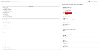

    But your anwser opens another question, How do you configure the TPS25751 to supply only Vconn from the PP5V supply?
    I couldnt find anything in the USBCPD Application Customization tool. (Also not in Advanced Config)
    VCONN is automatically supplied through PP5V. What you can change is how the 5-V PDO is supplied.
    When you configure Source PDO 1 in the "Transmit Source Capabilities" register, there is an option to change the power path.
    PP1 corresponds to PP5V, and PP3 corresponds to PPHV. If you want the TPS25751 to supply VCONN only from PP5V, change the power path to PP3 so the 5-V source PDO is supplied by through the PPHV power path.

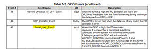

    Do we really need to have an embedded controller to reset the dead battery bit?
    Not necessarily, but options are pretty limited here.
    There is a single configurable GPIO event "Barrel_Jack_Event", that when asserted will set the fields mentioned, clear the dead battery flag, and will also trigger a power role swap to source.
    There is unfortunately no GPIO for just clearing the dead battery flag.
    We might be able to do some simple logic stuff (to clear the dead battery mode bit) like resetting the TPS trough I2Ct_IRQ when configured as PD Hardreset?
    I'm not sure what you mean by this. You cannot configure the IRQ to trigger a behavior in the PD controller.

    If thats not the case you seem to imply that we could configure a GPIO to "Barrle_Jack_Event" and toggle it momentarily to clear the flag?

    The Dead battery flag is only reset on the "DBFG" 4CC command(I2C), the Barrel Jack Event (GPIO), or if there is a power cycle and the PD controller comes up in a non-dead battery state (power from VIN3V3). Enabling or Disabling PP5V will have no effect on the Dead battery flag state.

    As mentioned above, there are only really 3 ways to deassert the dead battery flag. "DBFG", Barrel Jack Detect GPIO, and power cycling VIN3V3.
    To change from sink to source(using power rails), you would need to disconnect the source, then remove and reapply VIN3V3 to re-boot the PD controller. Basically, if the PD controller boots from VBUS power (no VIN3V3), the dead battery flag is set. If the PD controller boots from VIN3V3(and not VBUS), the dead battery flag is not set.
    This behavior would actually be really benefical as it would mean we could set the TPS to "source prefered" role and let the user select source/sink based on if the device is on or off / was pluged in before turnon.
    If you want to clear the dead battery flag using the Barrel Jack Event, it is recommended to assert and keep the GPIO high, not to toggle.

    I couldn’t quite understand what "Barrle_Jack_Event" does. It clears the Dead Battery flag but it also sets PORT_CONTROL.UnconstrainedPower and TX_SCEDB.SourceInputs[0] to true or false depending on rising/falling edge.
    However what does that do? I assumed it would communicate with the BQ25792 that it should use its alternative power input and draw as much current as it needs (trough VBUS) to reach the programmed charging current + Sys load.
    That doesn’t seem desirable as it would overload the USB-C source? Thats why i assumed toggling the pin to just reset the Dead battery bit but not actually go into an unconstrained power state.
    Maybe i am completely wrong about my assumption!

  • Hi Stephan,
    Unconstrained power and SourceInputs are PD messaging specific bits that indicate the power capability of the system. Just if there is unconstrained power or not. It's mainly for communication.
    I do have to make a correction, the Battery Flag clear does not necessarily initiate a power role swap.
    What it really does it that now you have system power and do not need dead battery, it will initiate a VBUS disconnect to renegotiate the contract.
    If you have the "Initiate swap to source" bit set in the "Port Control 0x29" register, on renegotiation it will try to negotiate the port to be a source.
    If you don't have this bit set, the port will come in the configuration set in "Port Config(0x28) -> Type-C State Machine".
    It should not overload the USB-C source. If the "initiate" bit is set, it may request a power role swap to source, but the Type-C source can reject it if the Type-C source is source-only.
    On renegotiation, the ports will negotiate roles according to what is supported by both ends, there should be no "forcing" of the power roles.
    To summarize, the "Barrel_Jack_Event" on rising edge will clear the dead battery flag and set the unconstrained power and source inputs fields high or low depending on the rising/falling edge. On rising edge, it also triggers a renegotiation of the connection on the type-c port.
    Depending on the state of the "Initiate swap to source" bit, it may try to become the power source, but if the device connected on the Type-C port is power source only, the TPS25751 will not force anything and will likely end up as power sink.
    Toggling it may be fine, but it will deassert the two fields.
    The primary thing that this does is it disables the dead battery flag which would allow the PD controller to swap to source.
    It does not communicate with the BQ25792 at this time to tell it to use alternative power draw.
