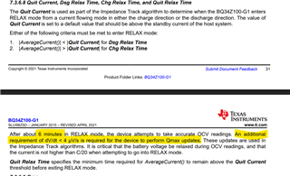

  • Hello Hocine,
    After discussing with my team we were able to conclude that the OCV measurements are taken after 6 minutes in relax mode when the current is below 4μA than a OCV measurement would take place however if these requirements aren't meant than 3600 seconds would be the period of a OCV measurements.

  • Thanks for your response.
    Is the 4 µV condition configurable? I couldn’t find any parameter that allows it to be modified.

  • Hello Hocine,
    No this is a default values and can't be updated
