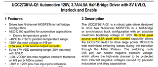

  • There is a confusing part in UCC27301 datasheet!
    what are the source and sink current values?
  • Hey Ryan,
    Thank you for pointing this out. This appears to be a typo in the Features section of the datasheet. I will make note so that this gets fixed with the next datasheet revision.
    The UCC273x1A has 3.7A source (pullup) and 4.5A sink (pulldown) current.
